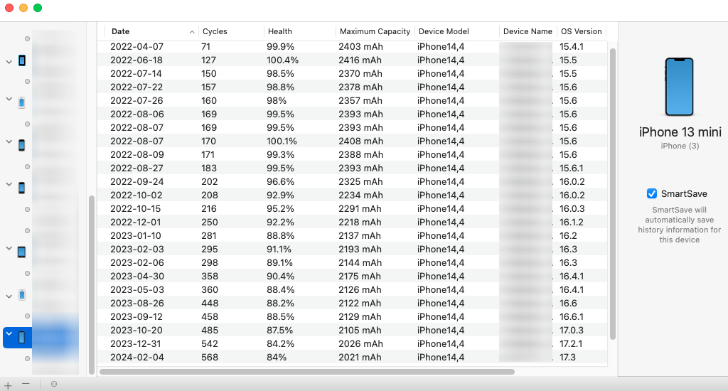

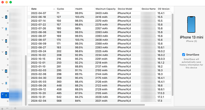

By the way, if you’re interested in tracking the performance of your iPhone batteries over time, the paid version of CoconutBattery does a great job of that.

To be a little clearer about what I meant by using the paid version of CoconutBattery (aka CoconutBattery Plus) to track battery performance over time, see the screenshot attached below.
When CoconutBattery Plus runs and an iPhone/iPad is connected, it will collect and store information about cycle counts, battery capacity, OS versions, and more, and it presents the information in a simple table. It will do it for multiple devices, and it also keeps track of different batteries installed in a single device. Of course, it also collects similar information about the Mac that it is running on.
