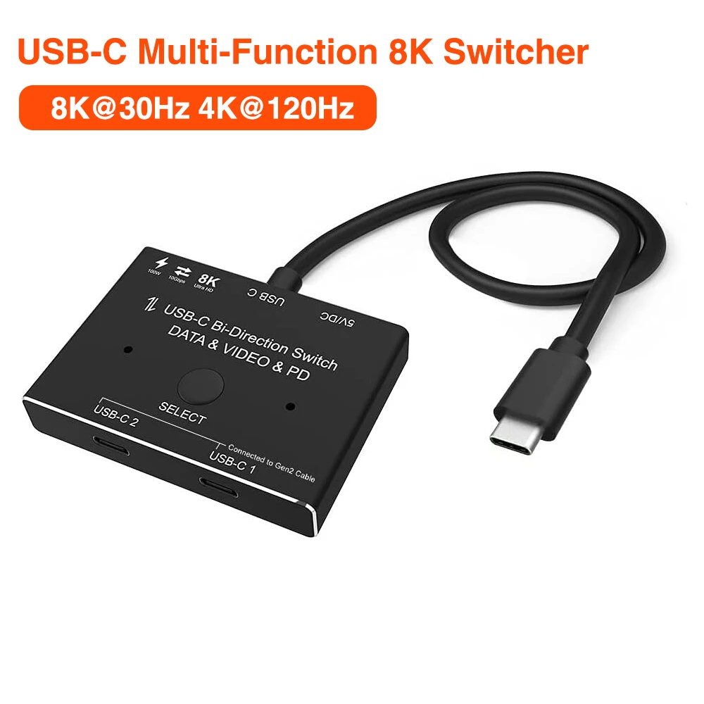

You might look at a USB-C Bi-Directional Switch that does data, video and power delivery.
There seems to be only one design sold by many brands.
