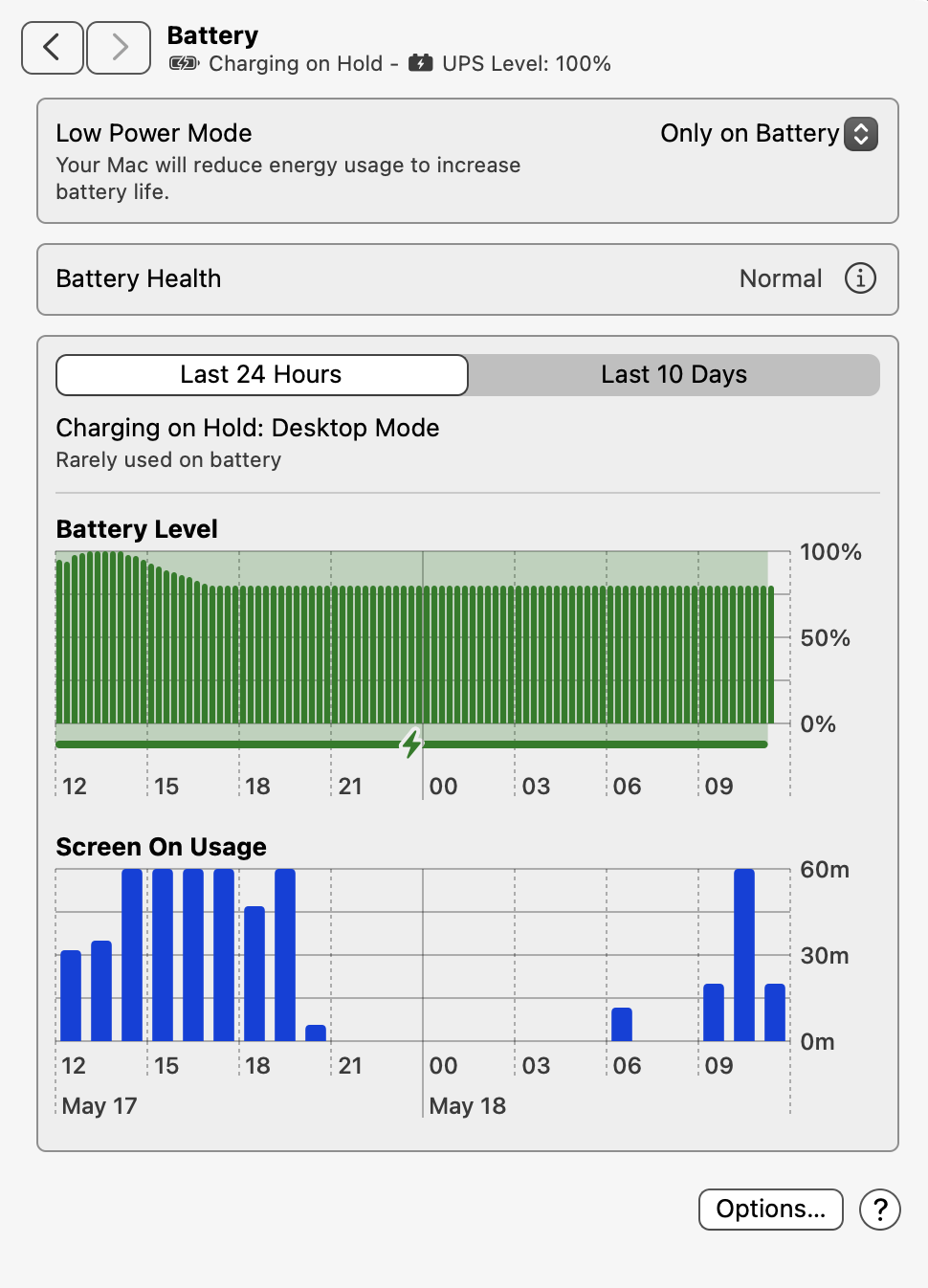

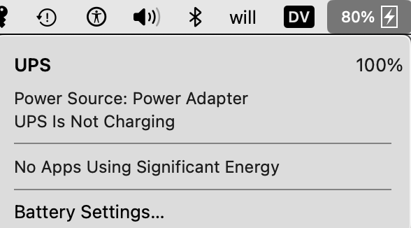

As a result of this thread, I looked at my APC BackUPS 1500, which seems to have an ethernet port labeled Data on the back. Dangling next to it was a cable with an ethernet plug (is that RJ-45?) at one end and a USB-A connector on the other end. (I assume the cable came with the UPS and I fiddled with it when the UPS was new.) I hooked it up to my MBA M3 running macOS 15.5 (actually to the TB hub) and found I don’t seem to have any option related to the UPS.
At the top, on the line just below Battery, there is a report that the UPS level is 100%. And the icon in the menu bar has changed, but again I see no option related to the UPS.
Maybe I don’t get an option because the Mac is a laptop?

And that cable is clearly working. Your first photo shows the UPS level at the top of the battery settings panel. And the status bar shows it as well.
As for why you’re not seeing the page I showed, I assume that’s because you are on a laptop. I would guess (but don’t know for sure) that macOS is going to combine the status of the UPS and the status of the internal battery and let you configure one set of low-power settings for both.
Note the documented differences between a desktop Mac and a laptop.
And this isn’t too surprising. For a laptop, macOS doesn’t have to care about the UPS’s state because it will always have the internal battery to fall-back on. The UPS is only going to be charging your battery, not running the computer.
