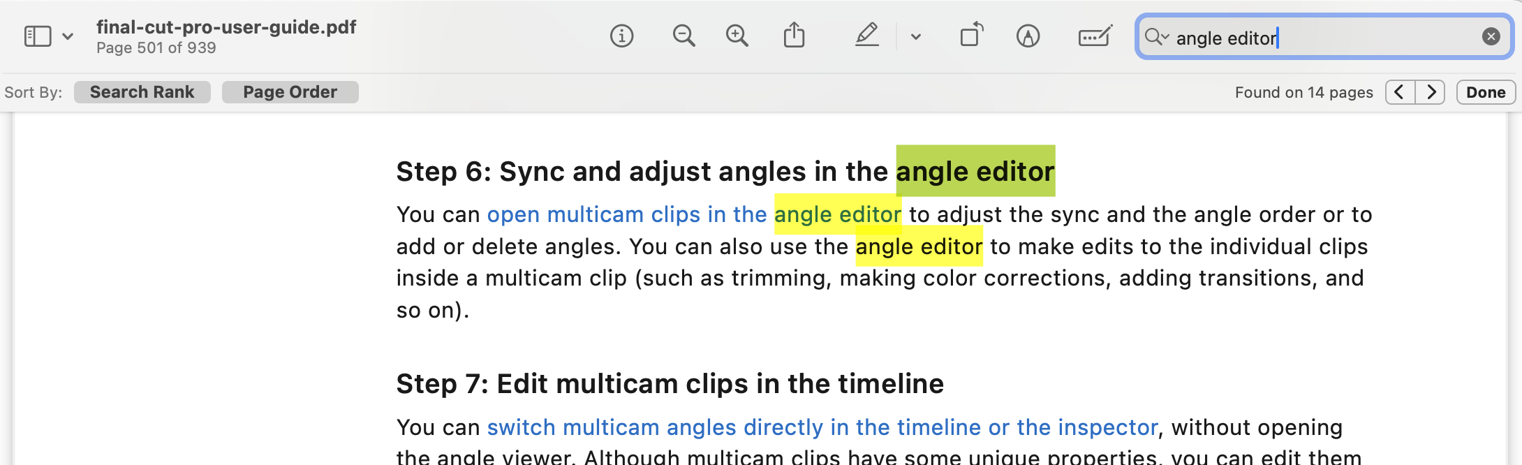

Question. I’m frequently crippled by not being able to search phrases in PDFs. My current example is that I’m trying to learn Final Cut Pro. The manual is 1000 pages, and the Table Of Contents can only get you so far. Sometimes I want to find mentions of the “Angle Editor”. If I search for Angle, I get lots of false hits. Searching for Editor, the same. I need the phrase “Angle Editor”. But unlike Google, I can’t quote the phrase to find it. If I don’t quote it, I get all hits on EACH work SEPARATELY.

Click the Magnifying Glass and change the type to “Exact Phrase.”

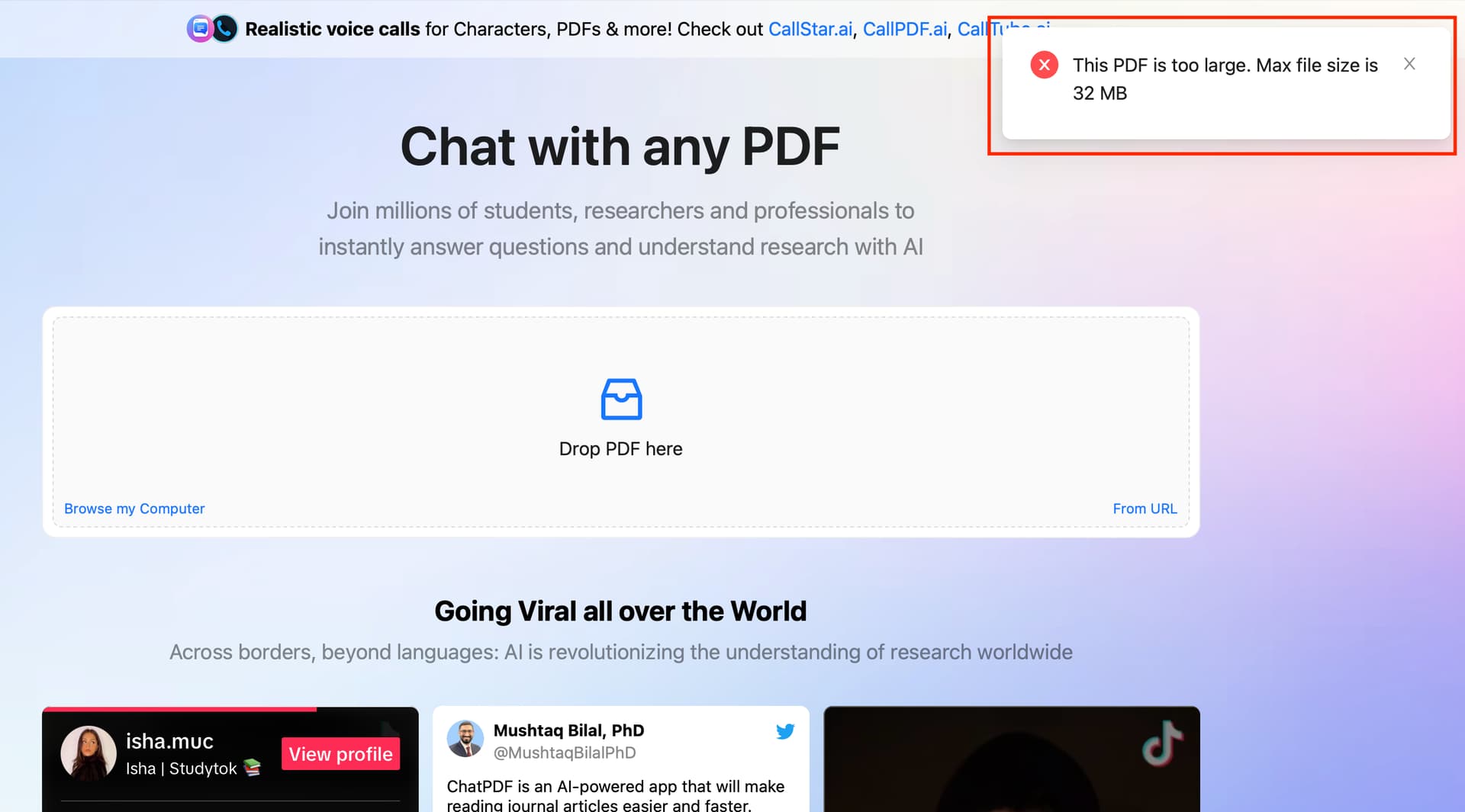

Makes sense, since there’s so much to hunt through in these larger PDFs. Unfortunately, and ironically, the larger ones are off limits:
(mine is 66 MB).
On the up side, I got to try the proxy icon trick. Since I keep this PDF in Books, I don’t have direct access to the PDF file to upload. But when I open the PDF from Books, it opens in Preview, and which I point I was able to drag the proxy icon into ChatPDF. Handy.
