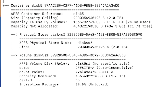

Found this old thread because I started doing a Finder encrypt of an external 2TB HDD on Friday afternoon 48 hrs ago. It is formatted APFS so has built in encryption but the instant on and off only applies to the internal drives, it does apply to externals.
The actual time depends on a lot of factors, but I learned that you can monitor progress by entering diskutil apfs list in Terminal:
So my 2TB HDD connected to an M1 MBA will take three days.

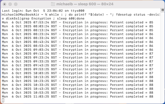

It is faster if you turn off I/O throttling: sudo sysctl debug.lowpri_throttle_enabled=0
You can monitor progress with while : ; do printf "$(date) - "; fdesetup status -device disk5s1|grep Encryption ; sleep 600;done

Your monitoring progress method is much better then diskutil apfs list because it updates itself if left running:
However turning off I/O throttling seems to have slowed it down. The first 75% took 55hrs (1.36%/hr) and the 13% since I turned off I/O throttling have taken 12hrs (1.08%/hr). Maybe it isn’t a linear process and it gets slower as it approaches 100%? I have re-enabled I/O throttling to see what happens.

Just to close this out now that the encryption is complete:
  1. 0-75% took 55hrs, I/O throttling on: 1.36%/hr.
  2. 75-88% took 12hrs, I/O throttling off: 1.08%/hr
  3. 88-100% took 10hrs, I/O throttling on: 1.2%/hr
Total time 77 hrs, avg rate 1.3%/hr. It doesn’t seem to make much sense that turning off I/O throttling should slightly reduce speed but maybe there is some deep explanation.
