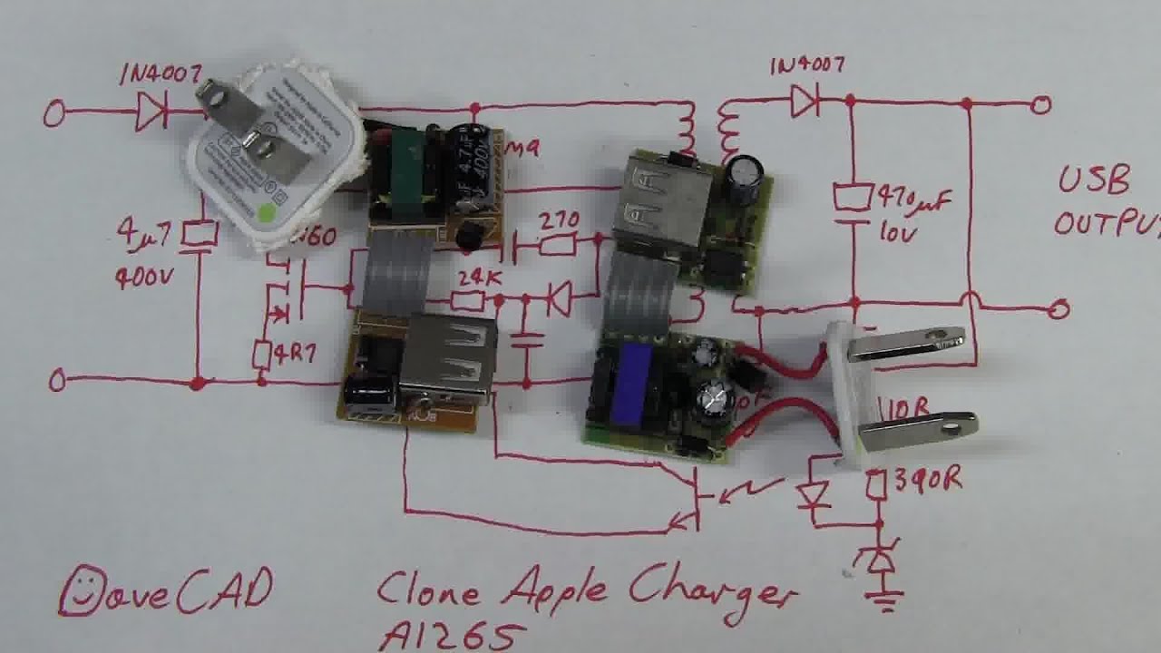

Old post, but I don’t see a newer one, has anybody tested to see if there is any different in those cheap add-on, plug-in, wrap to the back, QI receivers? You know the ones costing $3.00 straight from China, vs Amazon’s $14.00 with free shipping added into the product cost?
I’ve never bought a charger shipped direct from China. But in my experience with chargers, you get what you pay for within a price range, and the cheapest ones don’t seem to charge as fast or live very long. Also, I’m assuming you’d have to pay shipping from China, which would raise the price considerably.

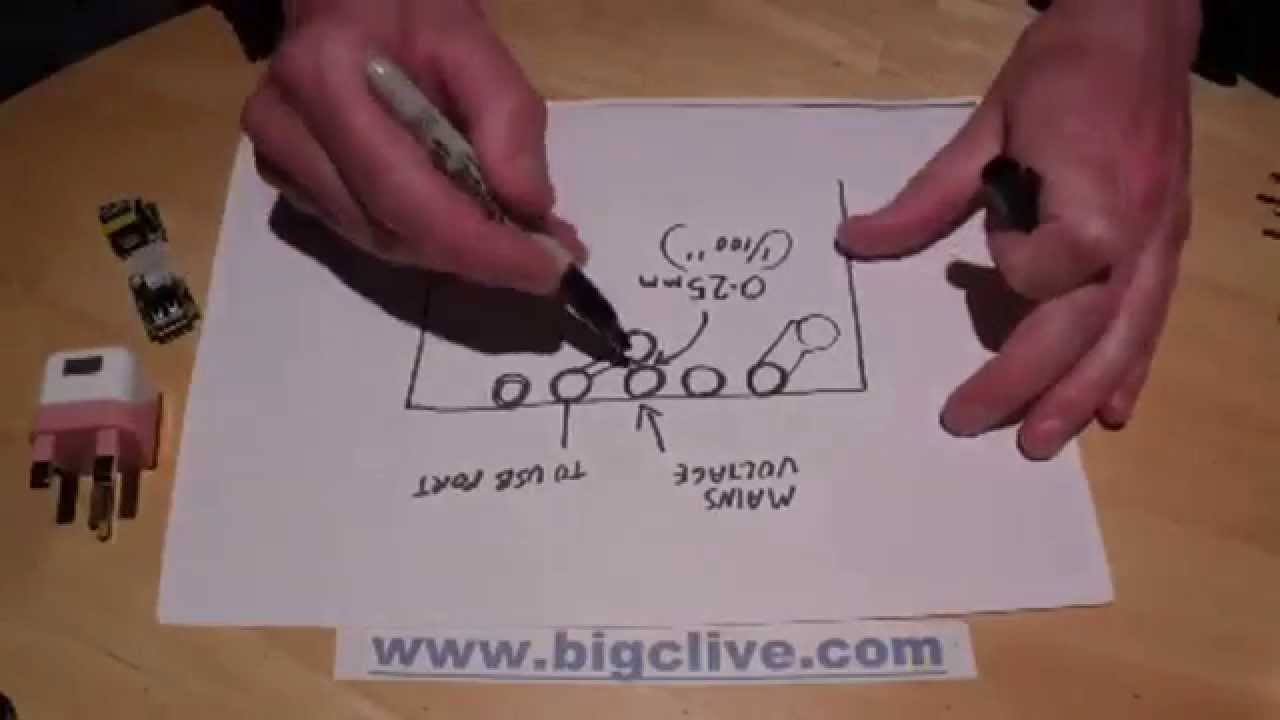

Cheap knock-off chargers are badly designed and often have critical safety defects. There are many videos on the subject that tear them apart, showing how bad they can be. Here are a few of my favorites:
After seeing many videos like this, I make a point of only buying chargers from well-known brands and only from stores where I can be reasonable sure that they are not counterfeit (meaning not Amazon).
For comparison, here’s a teardown of a genuine Apple charger:
