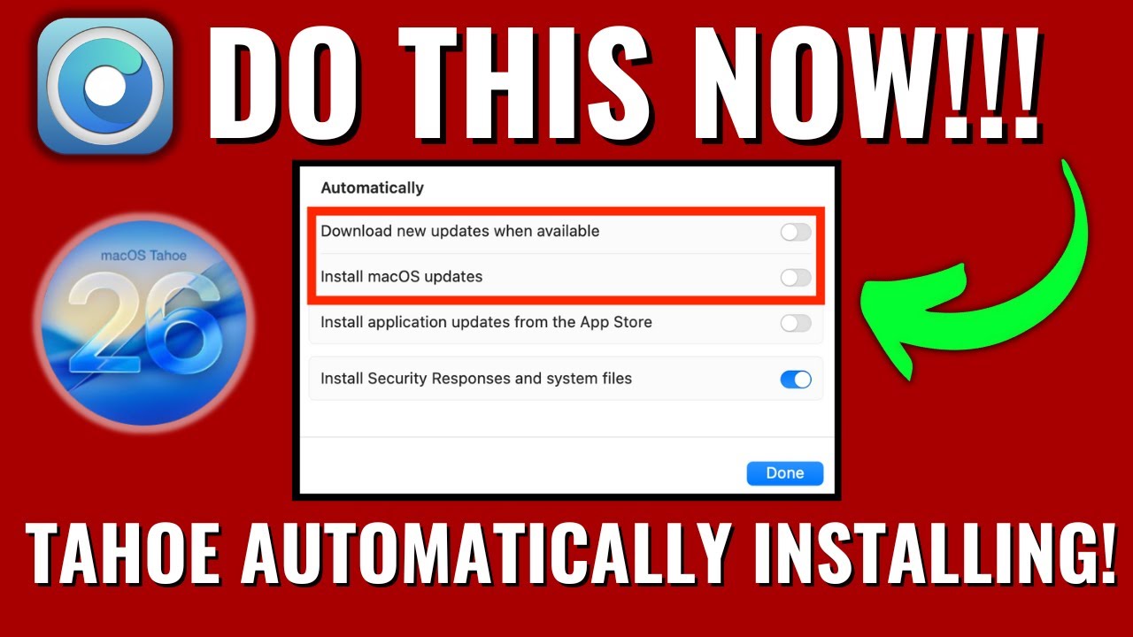

There definitely are concerns about accidentally upgrading to Tahoe on OCLP Macs. Mr. Macintosh has several recent videos on the subject.
Be careful out there!
Can anybody offer up the single-sentence advice so we don’t have to endure 10 min of YouTube influencer-ing?
