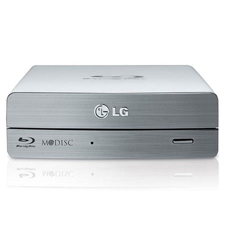

This is the LG drive that I use which is also a Blu-ray burner. It’s no longer made but I have found it to be reliable and trouble free. I don’t know if they have a newer model. I did get a second one on eBay in case mine dies since it works so well. LG drives have decent reviews so maybe your drive has issues or some of your discs might be scratched or have residue which can confuse iTunes as it is not as good a ripper as XLD or similar programs that check against a database. You can also just use XLD to get the metadata and then rip but for consistency, I use iTunes first so that both rips have the same metadata.

I see the model you mentioned and since it has the LG stamp, they are just using the bare drives which are sold from a lot of vendors and using their own case which should be fine. You have the lighter model which is probably similar to what’s in a laptop and I have a few of those as well but don’t use them much since my larger LG works so well and can do Blu-ray also. Those models should work fine but they do read/write at slower speeds. The Apple SuperDrive is not capable of playing or recording Blu-ray discs so that may be an issue if you ever want to use that option.
