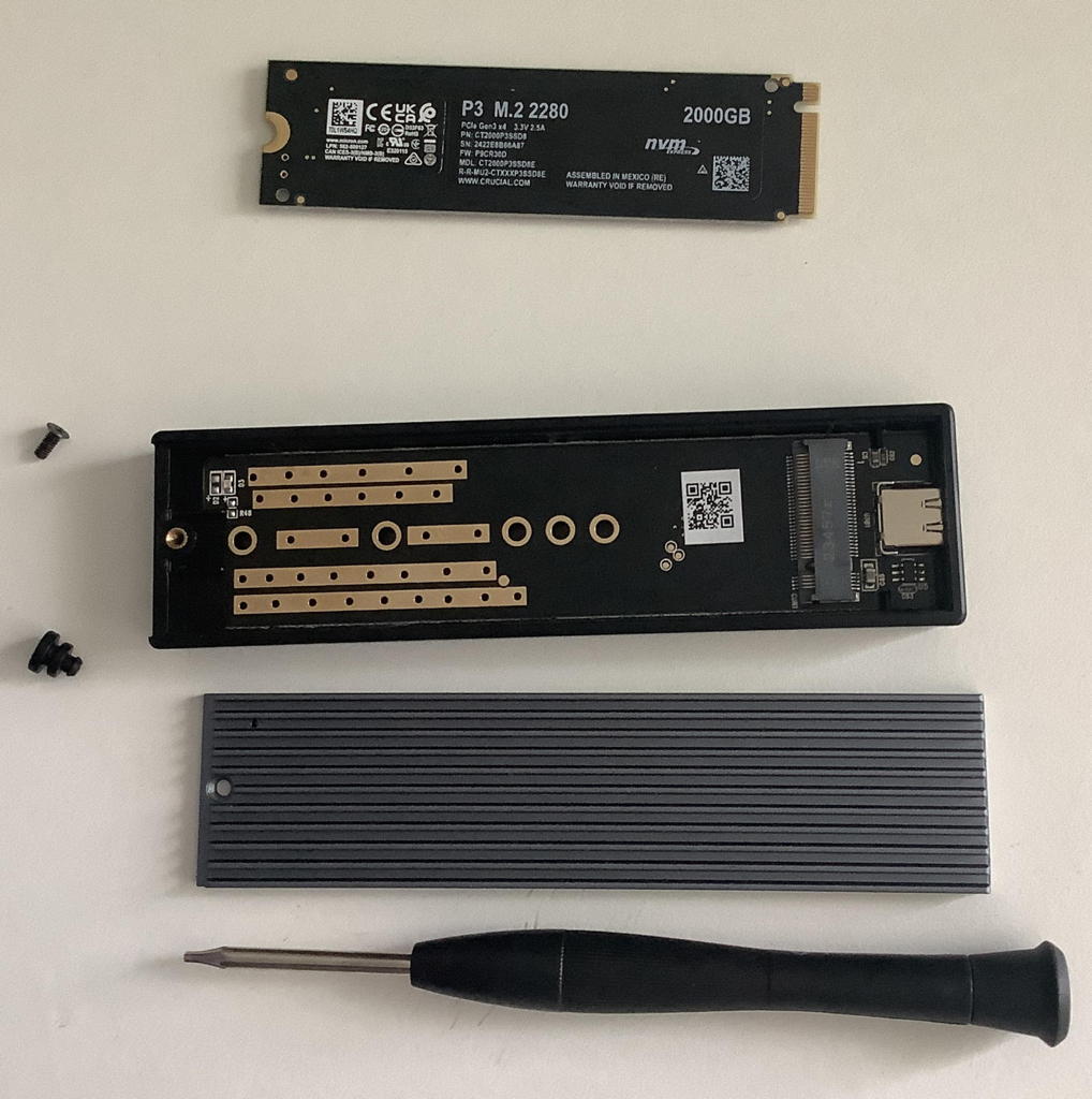

Here are some photos of the steps to preparing an NVMe M.2 SSD
The parts (SSD at top)

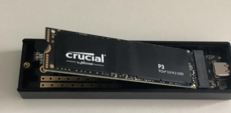

Insert SSD in the connector

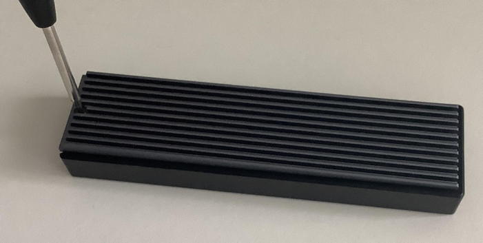

Scew down the top cover

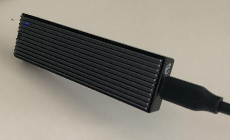

Attach a USB-c (or Thunderbolt) cable
