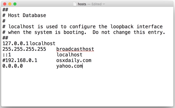

At a higher level, a blocking hosts file is quite nice–it stops a lot of stuff from even trying to load, which can speed up page loads and save on data use. But it does have drawbacks. It’s something of a pain to implement, and there’s no easy on/off switch if you’re blocking too much. If you really need to use some service that’s getting blocked (e.g. likely any site that insists on google analytics, including pretty much all google services), you may have to do some investigating to see which host names you need to unblock–but then it’s unblocked for all other sites too. I’m fine with this, because any site that’s that determined to track me I can probably live without. Plus I have a bunch of real and virtual systems, one intentionally unblocked for the very rare times I do need some site.
The best hosts file compendium I’ve found is Steven Black’s. He lets you mix and match from the better host file maintainers. Don’t be shocked that the files run to tens of thousands of lines. The one that blocks ads, trackers, gambling, porn, social, and fakenews, blocks about 90k site names.
GitHub - StevenBlack/hosts: šŸ”’ Consolidating and extending hosts files from several well-curated sources. Optionally pick extensions for porn, social media, and other categories.
To edit the hosts file on a Mac:
