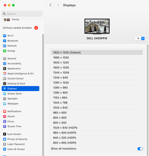

For instance, my display shows this in the system settings (macOS 15.7.1):
Note that some resolutions (e.g. 1024x640) have both normal and HiDPI variants. The normal ones will produce a signal with that resolution. The HiDPI ones will produce the panel’s native resolution (1920x1200), with the image scaled (by the computer’s GPU) to be an equivalent size to the specified resolution.
If you’re using a HiDPI resolution, try switching it to the normal version of the same resolution.
