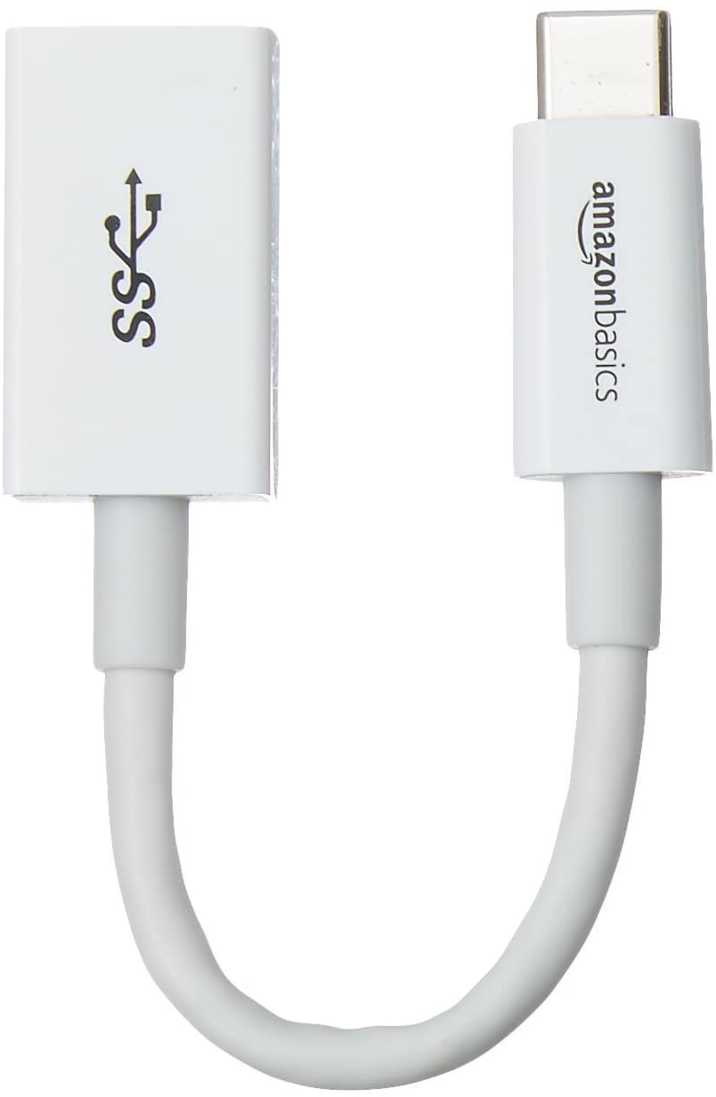

That display IIRC also requires a USB connection to alter its settings like brightness. So you’ll also need an A-C dongle, but then you should be fine with the DVI dongle (as long as it supports 1920x1200). Of course if you also want to use the monitor’s FW ports you’d need a FW400-800 adapter, a FW800-TB adapter, and a TB2-3 adapter. In principle, that should work for data only, but it’s prohibitively expensive and clunky considering its only 400 Mbps.
