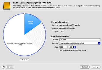

I typically have Disk Utility set to Show All Devices, but I changed it to Show Only Volumes and it showed five volumes: the Mac OS Extended that I want to delete and the four APFS volumes that reside in one container. With Disk Utility set to Show All Devices, one level up from the Mac OS Extended volume is the physical SSD, as is one level up from the APFS container (which is one level up from each APFS volume).

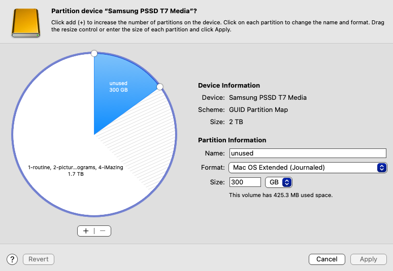

In Show All Devices view, I selected the SSD (one level up from the Mac OS Extended volume, as you said). I then clicked on Partition in the toolbar and got the window shown below. The - was gray; clicking it had no effect.
You can only remove partitions from the end of the disk, not the beginning. All you can do with the Mac OS Extended partition is to erase it and reformat it. You can’t merge it into the existing APFS partition/container.

Thank you. That explains why the delete is gray.

You can remove partitions at the end and expand the “previous” partition into it. Or you could say partition n+1 can be deleted and partition n expanded.
The partition at the beginning can’t be removed, but can be reused by reformatting. So it is not really a “hole”. Nuisance, I agree.
