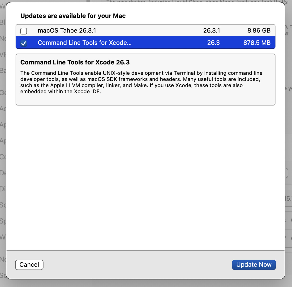

In Software Update on my MBPro M1 running Sequoia I see under ‘Also Available’ (apart from Tahoe) ‘Command Line Tools for Xcode 26.2’ . I think I tried installing HomeBrew or something similar some months ago. I couldn’t use it and no longer am interested in it. How do I stop Software Update showing this? I can’t see Xcode or HomeBrew anywhere in Applications or utilities folders.

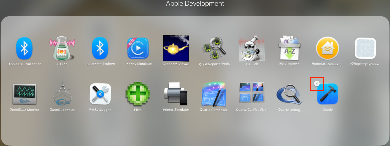

Although many sites say you can remove Xcode by just dragging it to the trash, I think the easiest way is to uninstall it via the Launchpad, as you can do for any app installed from the App Store. (I don’t know if this will work in Spotlight’s app-browser that replaced Launchpad in macOS 26).
  • Open the Launchpad
  • Locate the Xcode app
  • Long-click on it, causing the icons to wiggle
  • Click on the “X” icon in the corner of the icon to uninstall it:

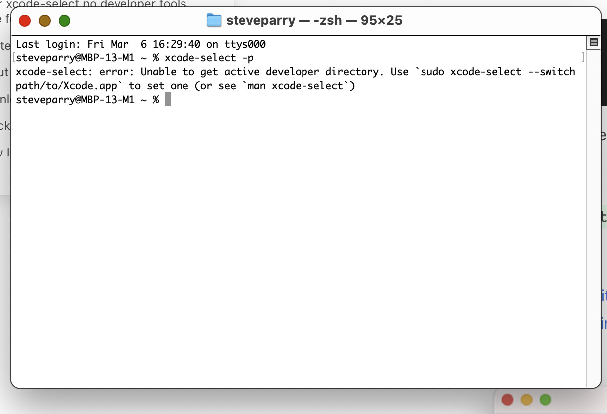

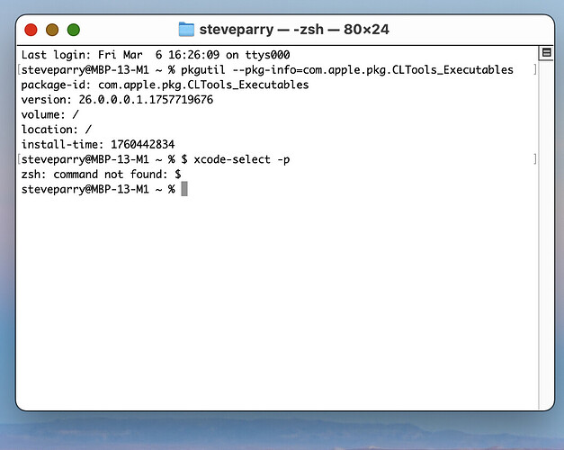

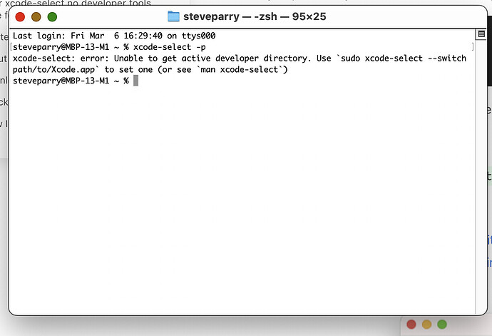

Struggling with Terminal as always. But it seems, from running the command on that website, that it is present. Attached is what I get in Terminal when looking for/trying to remove Command Line Tools
The initial $ in the page cited by @oldschool is a prompt (the equivalent of your steveparry@MBP-13-M1 ~), not something you should type.
Thank you. So it seems Command Line Tools is NOT present - see attached:

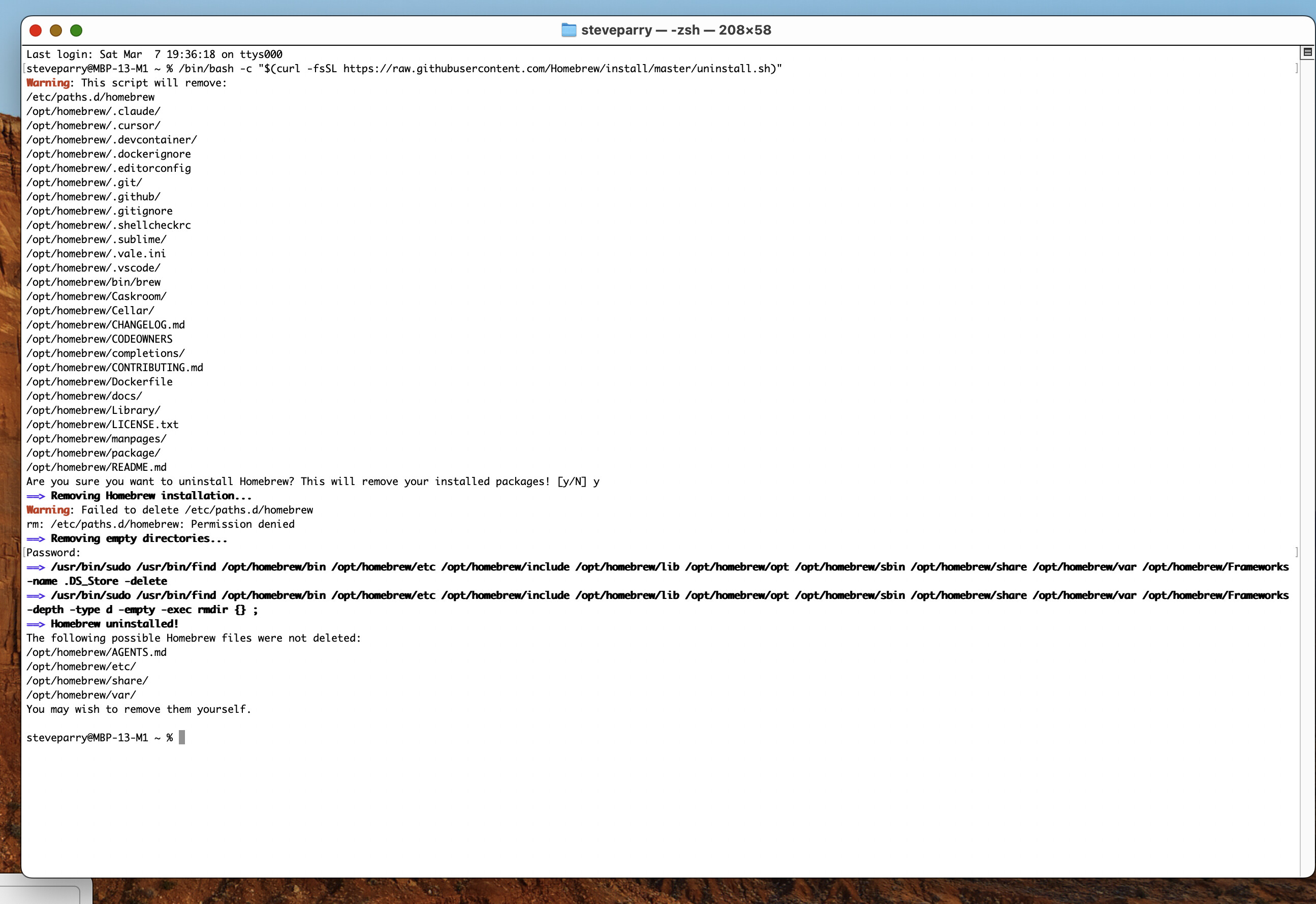

If you think homebrew is still there, and you want to get rid of it, try this terminal command (include the quotation marks at the end):
/bin/bash -c “$(curl -fsSL https://raw.githubusercontent.com/Homebrew/install/master/uninstall.sh)”
NOTE: after posting the reply, I see the site “breaks” the entire command, and misinterprets the latter part of the command as if it were a URL. You want to copy from /bin (above) all the way to the end .sh)” and then enter that into terminal. There is a space character between fsSL and https .
I’d suggest a reboot afterwards.
With homebrew gone, it -might- result in software update forgetting about updates.
(No promises).
If homebrew is NOT installed, terminal will just tell you it’s not there after you enter the above command.

When you ran the pkgutil command, it showed that you have the Command Line Tools installed.
The xcode-select -p command result shows that you do not have the full Xcode environment installed.
You can have the Command Line Tools installed without having the full Xcode app installed, which appears to be your situation.

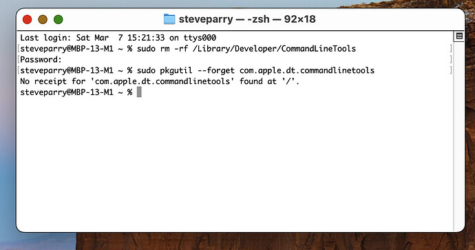

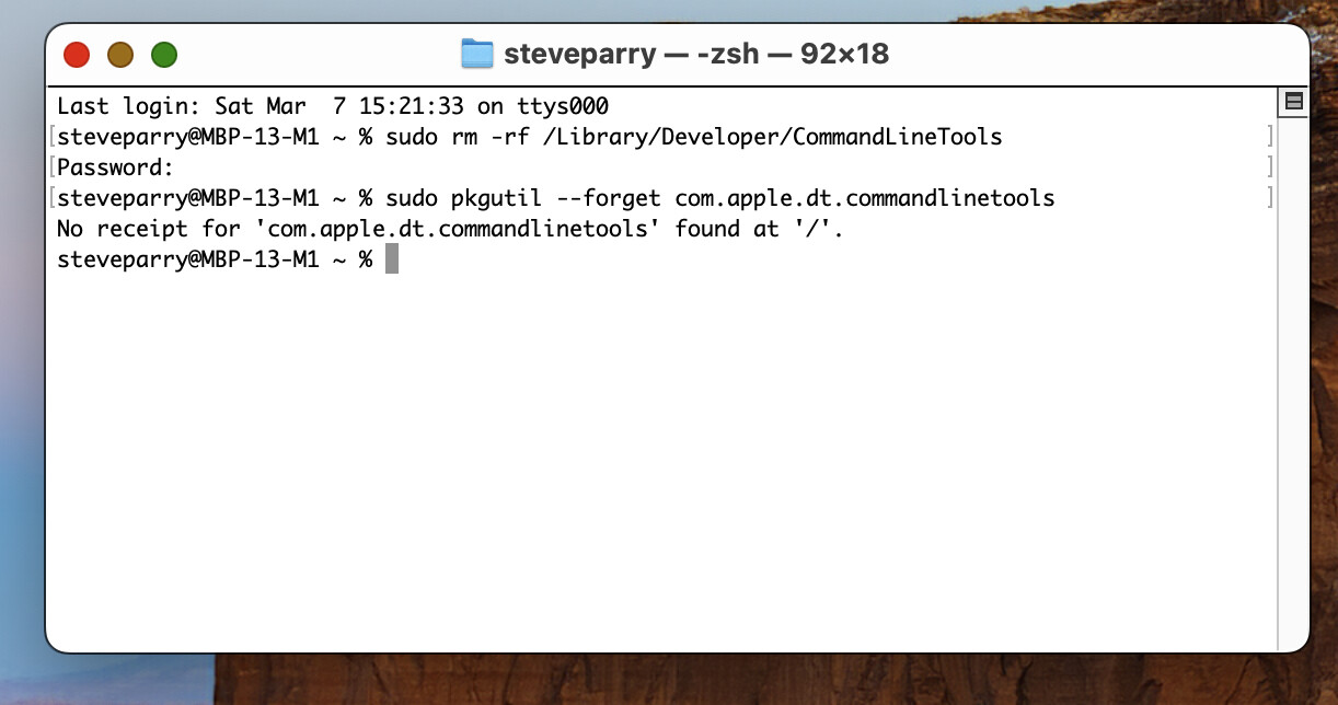

Instructions for removing the Developer’s Command-Line Tools According to Apple’s Developer Documentation
To remove the package from your Mac, run the sudo rm command with the -rf option in Terminal:
% sudo rm -rf /Library/Developer/CommandLineTools
Note - The sudo command requires administrator privileges. Enter your administrator password when the system prompts you.
After removing the package, you’ll continue to receive new releases of the package in Software Update on your Mac. Delete the package receipt to opt out of software updates for the package.
To delete the package receipt, run the sudo pkgutil command with the --forget option in Terminal:
% sudo pkgutil --forget com.apple.dt.commandlinetools
If the task succeeds, pkgutil prints the following message:
No receipt for 'com.apple.dt.commandlinetools' found at '/'.

I get this so i guess Homebrew isn’t installed:
Looks like this could have been successful:
Looks good!

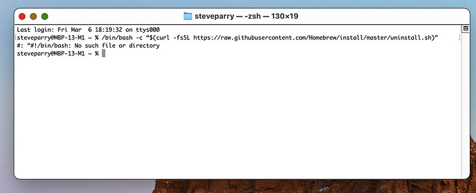

I’m not 100% sure, but I think I see “curly quotes” in your /bin/bash command, which should be "straight" quotes. That might cause the No such file or directory error, and Homebrew might (still?) be installed.
After rebooting the update was still being offered… Ashley, I think you’re correct. I put straight rather than curly quotes in and got the below response. I’ll try rebooting now and see if it makes a difference.
Rebooted again and still there.
