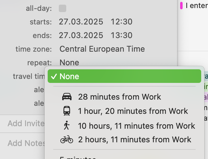

Calendar in macOS using wrong start location to calculate time to destination
When having Apple Calendar calculate the travel time it uses my work location as “from” although I am at home using my Mac mini .

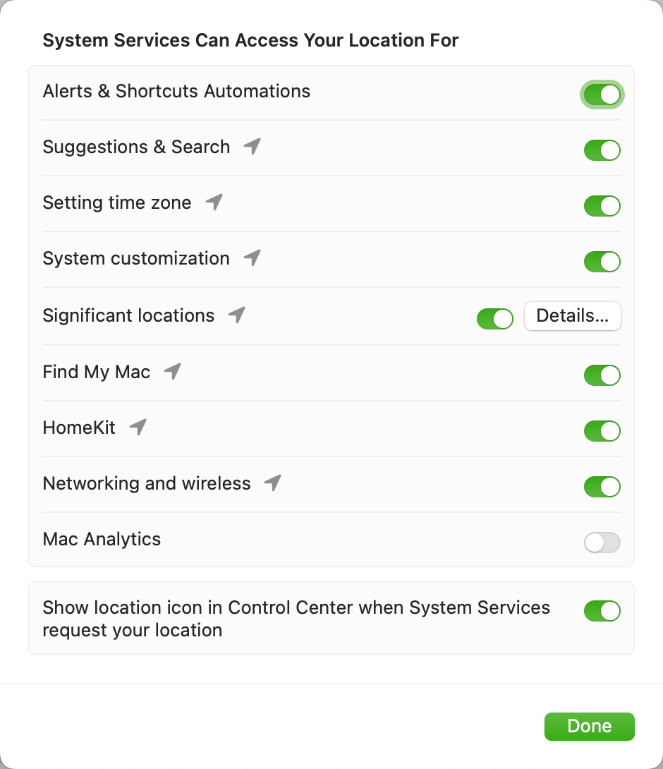

Location services is turned on and my Contacts card contains the correct home address in an entry called “home”.

If your Mac has location services disabled, or blocked from Calendar, then it’s going to fall back to something like a last-cached location.

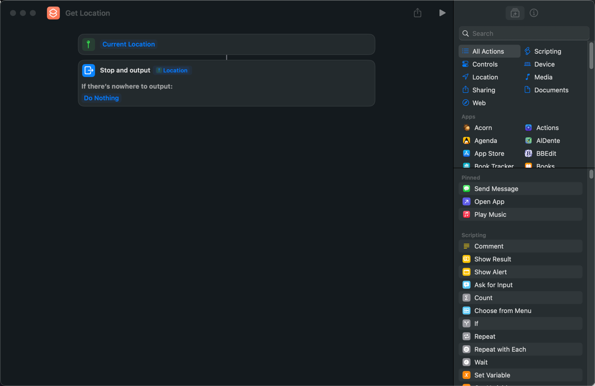

You could try creating a shortcut for “Get Location” to see what your mac thinks is the current location. Might be useful for troubleshooting.
See below - it’s really quite simple - run the location command for the current location, then stop and output the location identified.
