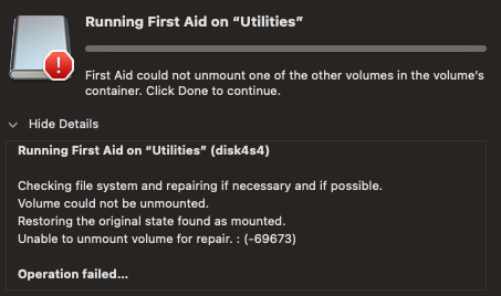

Run FIRST AID on each of the partitions and then the entire drive. that should allow you to reformat it then.
Tried that but got this for all 3 partitions:
Oh, remembered I had DiskWarrior, so tried it. MAssively slow, but I rebuilt the directories on all 3 partitions. Made no difference.
No idea what other options I have… except to toss the flash drive. Now it seems that I can NOT even eject the damn thing. Oh after a few minutes I get the “in use by another program.” Eventually I got an option to force ject, after a few min sutes fussing with that, it did get ejected. BTW, as I reated it back when I was running HS on my cMP, all 3 partitions are HFS+.

Looking at the error messages, it seems the reason you cannot reformat nor run disk first aid is that the volumes cannot be unmounted. That’s the reason ejecting the disk eventually requires a Force Eject.
I have 2 ideas, first, leave the flash drive mounted overnight, then try to eject it in the morning. That may give the system time to do whatever its doing that has the volumes busy.
If that doesn’t work, force eject the volumes, leave them unmounted, and then reformat the disk using disk utility.

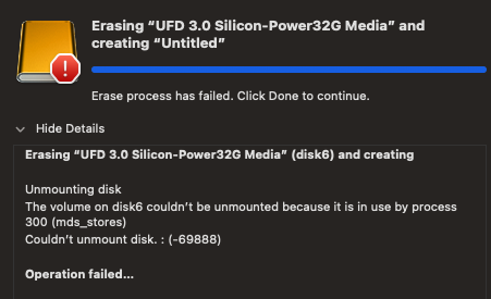

The first screenshot posted tells exactly what process is blocking unmounting: it is mds_stores, which is part of Spotlight indexing. Perhaps if you remove the volumes from Spotlight, you will have better luck.
That doesn’t make sense to me. The error refers to “one of the other volumes in the volume’s container”. That means APFS, which Disk Warriror can’t repair.
If these three volumes are all part of a single APFS container (Disk Utility should be able to show you this), then you have to unmount all of them in order to perform a repair. Disk Utility is trying to do this for you, but it can’t, hence the error.
If these volumes are actually HFS+ formatted, then the error message makes no sense to me.
Or the partition table could be messed up such that part of the device think it is HFS+ and part thinks it is APFS. That would explain a lot of the mess as well. If there was an attempt to convert the storage from HFS+ to APFS, and the attempt failed or was stopped halfway-through (e.g. power failure or disconnecting the device), that might do it.

Great. This means that whatever was running (and therefore holding open files, preventing unmounting) has finished. Given the original screen-shot, it was almost certainly the mds_stores process, which is Spotlight’s indexing daemon.
As for why it couldn’t be interrupted (and was therefore blocking the unmount), I can only speculate, but it may well be that it was reading and analyzing that 5GB file. It may only be able to pause itself between files, not while processing a single file.
Previously, you force-unmounted the drive before mds_stores finished or got to a checkpoint, which probably caused it to start over.

Have you tried opening Activity Monitor and quitting mds-stores and any other mds-related processes? They will eventually restart, but you have a small window to start the deletion. Just have Disk Utility already running so that you can quickly start the deletion.
No, and I should have mentioned that. I was worried about quitting processes, and you implied there’s no problem. Even if they restart, does anything bad happen from forcing them to quit?
There’s one other reason I wouldn’t have quit the process even if I knew it wouldn’t hurt anything. It’s a new Mac, and I hadn’t told Activity Monitor to show All Processes. When I looked for mds_stores (both by PID and by name), it wasn’t there. Thanks for prodding me and making me think to tell Activity Monitor to show All Processes.
It’s great to be cautious, so here’s a fuller explanation of how I would approach this fix.
One thing I do before messing with a process is do a web search for ‘mac process-name’ and try to get a basic understanding of the consequences of quitting the process. Since the mds-store process is part of Spotlight indexing, the worst thing that could happen is that the Spotlight index is trashed. So let’s see if that can be easily fixed without causing other problems.
The process I would follow is to
1)Start Disk Utility
2) Quit mds-store from Activity Monitor (force-quit if necessary)
3) Erase the flash drive
4) Rebuild the Spotlight index as described in the support document
5) Reboot (to get a fresh start)

I took matters into my own hands yesterday, when I was ready to quit for the day. The mds_stores was using 0% CPU time, so I quit it. (Force-quit was not necessary.) I then deleted the APFS partitions and unmounted the SSD. I’ll pick up on your instructions at step 4. Thanks again.

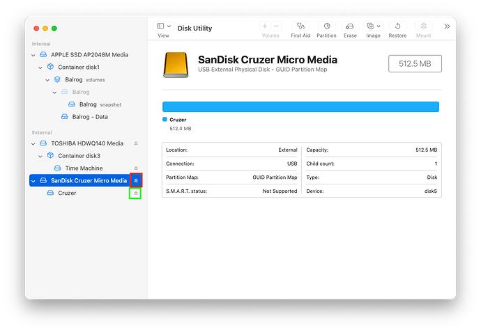

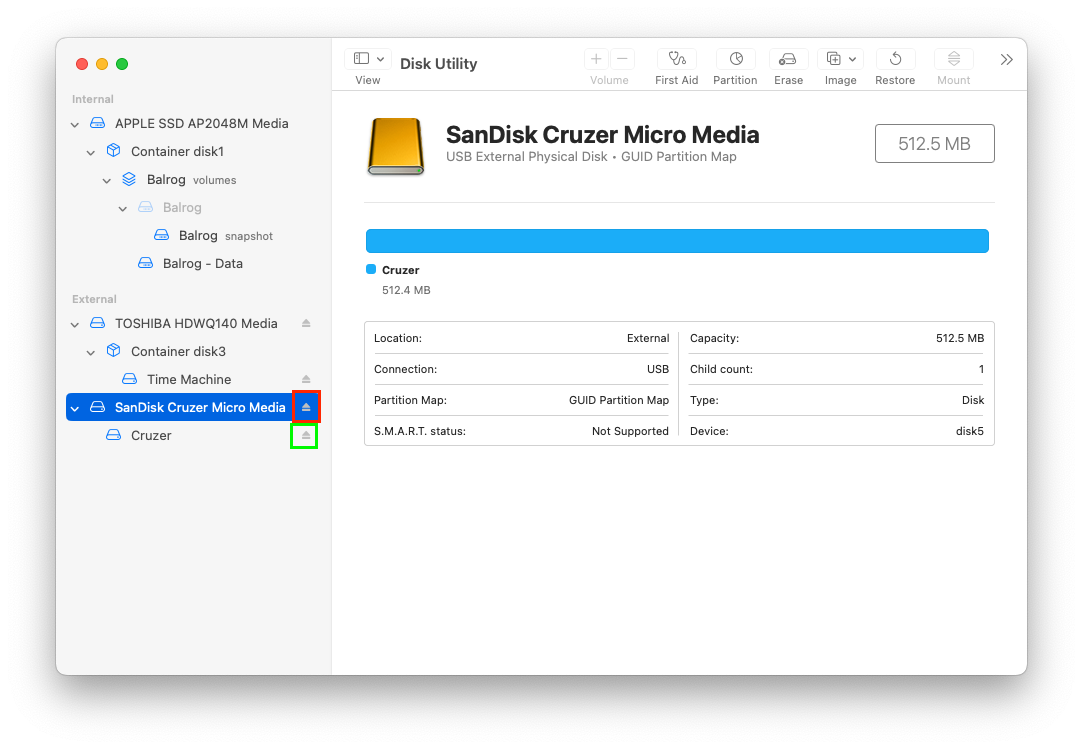

Bonus question. What is the difference between unmount and eject? In Disk Utility, with Show All Devices selected, I usually click the top triangle for the device (and then wait for all the volume indicators to turn gray, which can happen some seconds after the icons disappear from the desktop). I assume I’m unmounting all the volumes and ejecting the device; is that the standard terminology?
In general, unmounting is something you do to an individual volume (aka filesystem), while ejecting is something you do to an entire physical device.
IIRC, if you have a device with multiple volumes, you generally can unmount one volume while leaving the others alone, but if you “eject” one of the volumes, then all of the other volumes should be unmounted, too. Also, if your device has physically ejectable media, like a DVD, the eject command should physically eject the media.
In practice, on devices with a single volume, unmount and eject look the same to a typical user.
I don’t have a machine nearby to confirm this, but I think the story is more complicated with macOS 10.15+ devices that contain linked volumes, like a Sealed System Volume and an associated Data volume. I may be wrong, but I think if you use Disk Utility to unmount one, the other will get unmounted, too.
Another big difference is that when you “unmount”, the device doesn’t go away. So you can re-mount it again. But after an eject, the device is removed from the system - you need to power-cycle or hot-plug the device to get it back.
You can see this in Disk Utility. Plug in your favorite flash drive and select its volume. If you click the “unmount” button, you can later click “mount” to get it back. But if you click the “eject” icon (in the left-side column), the device disappears from the list. You will need to remove and reconnect the drive in order to get it back.
Is that the triangle with a vertex at the top and a line underneath?
What you describe is not what I see, but I’m using an SSD. Is that the reason for the difference? (I can click the triangle and choose Eject from the File menu for each volume, but the device remains in Disk Utility’s window and I can click the mount icon and get it back on the desktop.)
Yes, but there are two of them, assuming you have Disk Utility configured to show all devices (View → Show All Devices, or type ⌘2):
The icon next to the volume (green box in my screen-shot) does an unmount. The icon next to the device (red box in my screen-shot) does an eject.
If your Disk Utility is configure to only show volumes (the Apple-default configuration), then you will only see volumes, and the icon for them does an unmount, not an eject.
