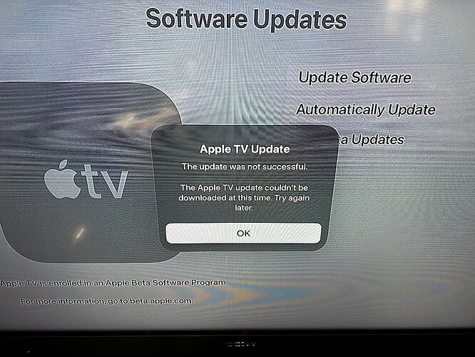

Apple TV won't update
About 2 months ago my AppleTV 4K started refusing to update to the latest tvOS. I receive notice that there is a new version, but after a couple of minutes, there is an error message saying, in effect, “no soup for you”.
The first few times this occurred, I ignored it, figuring it to be some issue at Apple’s end and the device works as it should otherwise. But weeks (months?) later, I still get this error. I’ve tried restarting a few times, I tried enrolling in the Apple Beta Software program, is there anything else I can try?
Have you tried to delete Apps on there in case this is an issue with not enough room to update?
It may be a pain, but you can try factory resetting and set up as new. I just replaced an old Apple TV HD with a 4K yesterday and I had it all set up in less than 30 minutes, including setting up HomeKit, logging in to all of my apps, checking to make sure settings were right, etc. I do use the feature that keeps all of my Apple TVs in sync, which includes which apps are installed, where they are placed on the home screen, etc.
Interesting thought, though I use the Offload function. I checked anyway to see if I should Offload or delete any other apps, and found one app was stuck updating because it was no longer available in the App store. I deleted it, and found 4 others similarly stuck mid-update. I deleted them all, and tried to update the OS again. It seems to be working, at least I haven’t gotten that error message yet after 15 minutes (the old error would always show up after about 90 seconds). Fingers crossed…

Update: after removing a few “stuck” updating apps, and downloading a new App channel just to see if that worked (it did), I tried updating the OS again. After a few hours, nothing happened. I then switched off the “Beta” toggle, and was able to download the current 17.x standard update successfully.
However, when I tried today to update to the AppleSeed Beta for tvOS 18, the same pattern happened- i.e. nothing useful.
Oh well, at least I updated to the current public release.
