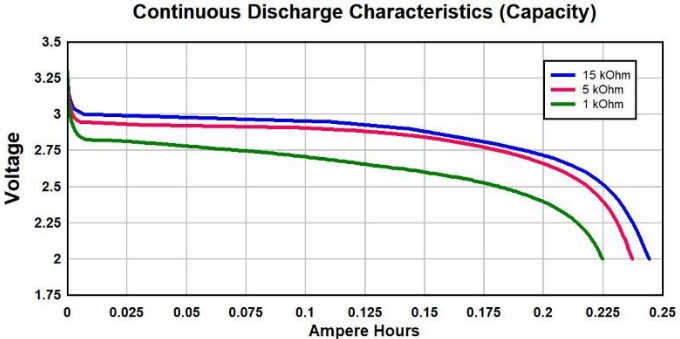

The nature of Lithium coin cell batteries is that it is very hard to measure remaining lifepsan. Battery life meters typically measure the voltage and compare it against a curve representing how much power is left. But the nature of lithium batteries is that the line is almost horizontal (constant voltage) until the battery is nearly dead, then it sharply drops to zero.
For example, see the data sheet for a Duracell CR2032:
Notice how it is running nearly at its nominal 3v output for nearly 50% of its lifespan (at 125 mAh), then it drops fairly smoothly to 2.75v from there for the next 30% (at 200 mAh). Then it quickly curves down to dead for the last 20%. Any estimate of lifespan is going to be meaningless for the first 50%. And once you hit 80%, you’re on borrowed time.
Given the fact that a meaningful number will only exist for about 30% of its lifespan, showing a computed percentage will be meaningless and/or confusing to people who don’t understand battery chemistry. Better to just report good/bad at some threshold voltage. Which is what the AirTags are actually doing.
(It’s also interesting to note that the battery’s nominal capacity of 245 mAh is assuming a 2v cut-off voltage and a 15 kΩ load. If your device has a higher load (lower resistance) and/or can’t operate at 2v, then your device will fail before you get 245 mAh from it. Something that is clear from a data sheet, but usually isn’t very clear on retail packaging.)
