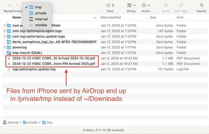

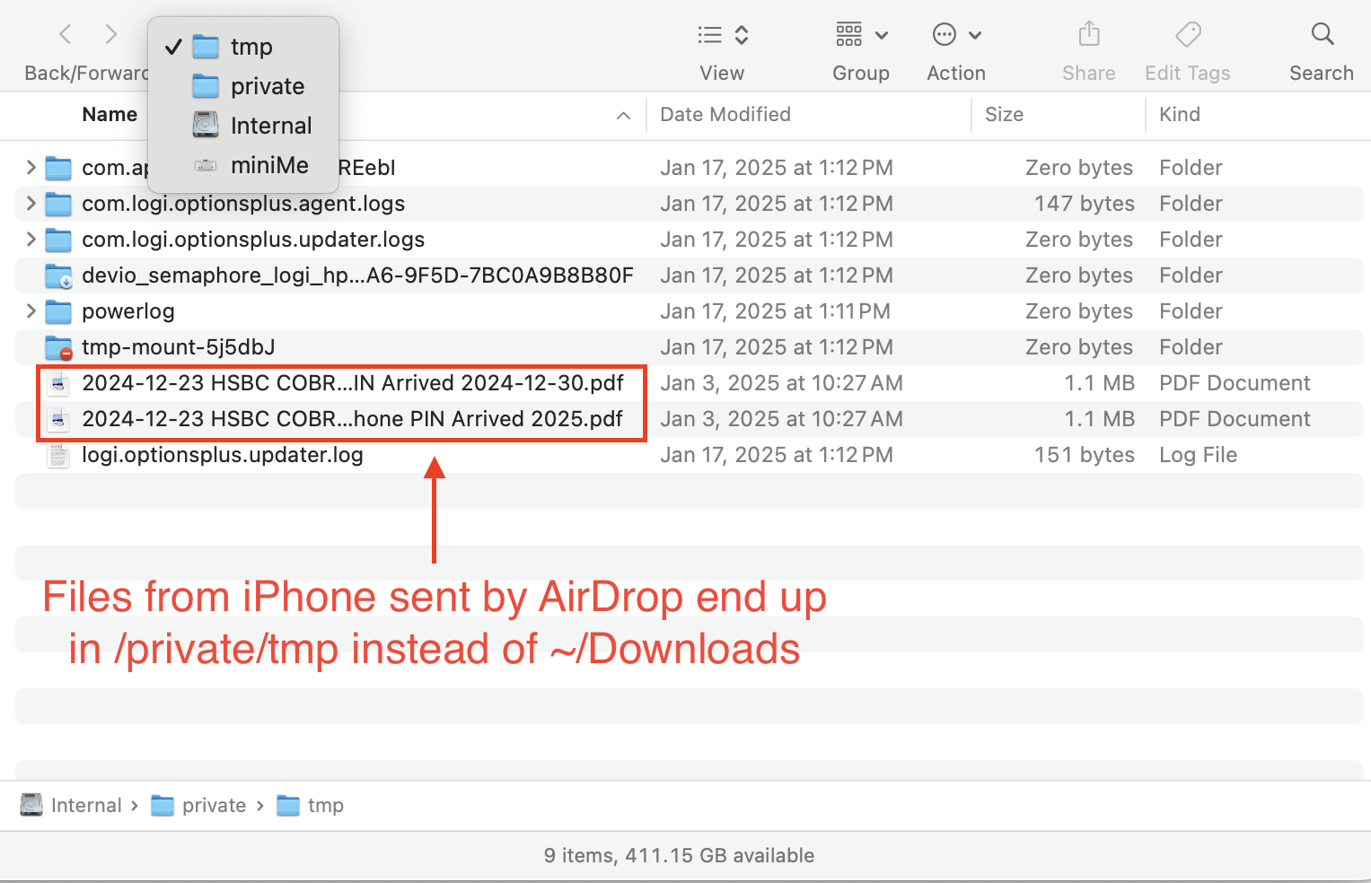

Now whenever I AirDrop a file from my iPhone 15 Pro Max running iOS 18.2.1, the file ends up in /private/tmp instead of ~/Downloads, as you can see in this screenshot:

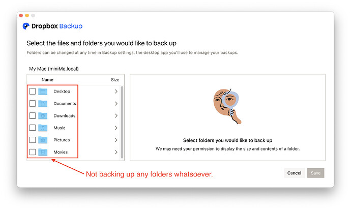

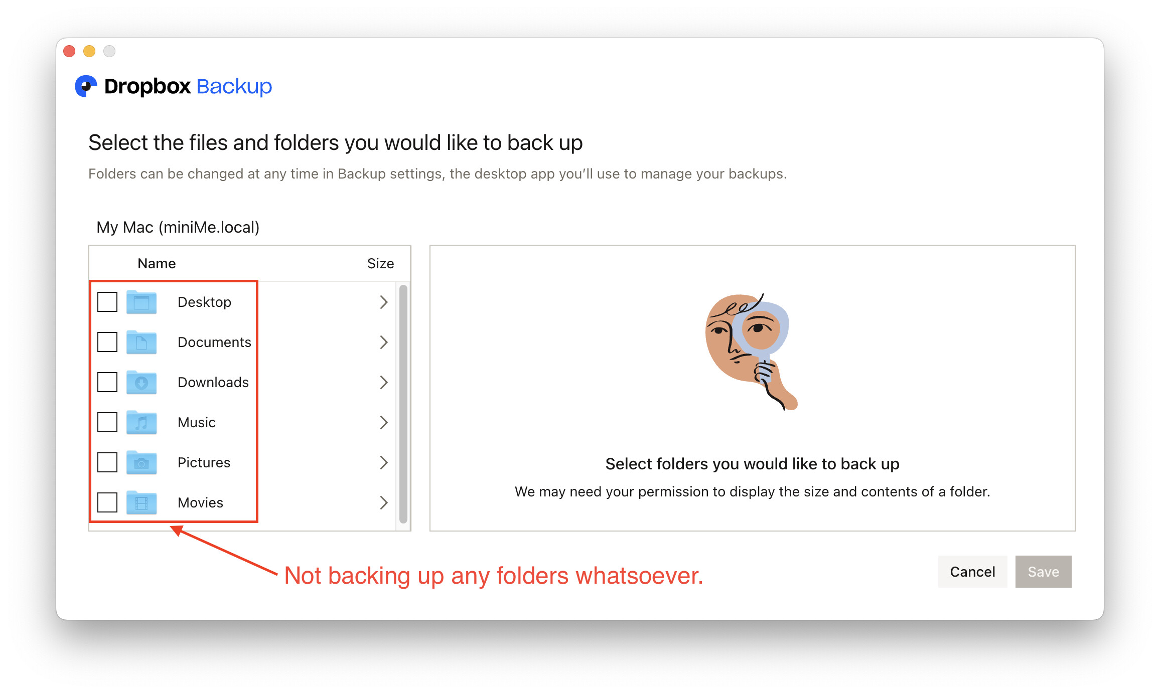

Nevertheless, do NOT have Dropbox set up to backup any folders, including ~/Downloads:
I have the free version of Dropbox so the only way I can contact them is to post on their Community, which I did, but I’ve received no replies.
