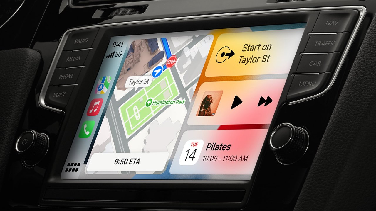

With CarPlay you would have direct access to audio controls. It has a screen that shows the navigation app on one half and the audio controls in a section of the other half:
(Photo from https://appleinsider.com/inside/carplay)
Right. Plus with CarPlay, you have a fairly safe interface to switch between all your different music, podcast, and audio book apps, not to mention texts and voicemail and phone calls. You can do some of this with Siri, but it’s no comparison to the level of functionality and productivity you get with a heads up, driving-friendly interactive interface like CarPlay.

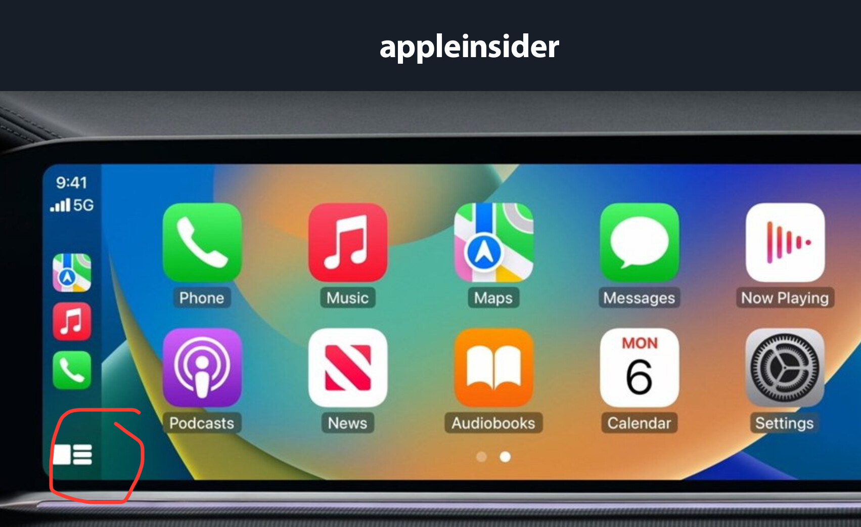

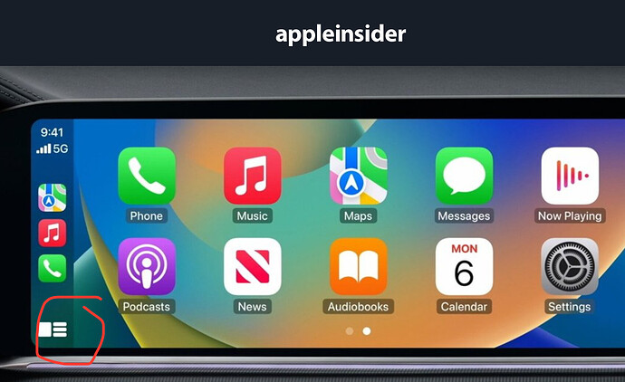

You press this little split screen navigation icon on the lower left and it splits the screen for you.
Split screen was in iOS 16 as well. See Intro to CarPlay and iPhone - Apple Support and change the version from iOS 17 to iOS 16.
Nope, that split screen icon isn’t there. Does it require a particular version of CarPlay? Unless it can update itself in the background, ours is six years old (2018 Kia) and there’s no indication that Kia has ever included an update to that in their computer updates (of which we’ve only had to do two, one during the first year and a second when they fixed our car after the “Kia Boys” struck last summer—they didn’t succeed in taking the car, but they broke a window, and tore up the steering column and ignition switch trying).
The other thing I’m noticing in those screenshots is how much of the screen real estate half the width is. The screen in our Kia is not nearly as wide as the ones in those screen shots, and I don’t want to reduce the map to only half the screen—that would be narrower than the screen on my iPhone 12 Pro Max in portrait (which is how I normally mount it in my car), as the Kia’s screen is only 7 inches on the diagonal (it appears to be roughly a 4:3 ratio—I can’t find any specs online for the factory screen except that it’s a seven-inch diagonal—which would make the half screen width, after subtracting the left sidebar, about 2.5 inches, compared to the 12 Pro Max with a screen just over 3 inches wide). Is the split screen size adjustable, or is it only half-width?
No, it’s been in CarPlay in the last several iOS releases. And the car manufacturer just has to support CarPlay – what appears on the screen is determined by the iPhone (so it wouldn’t be based on a Kia update or not).

The icon is contextual. Sometimes it shows a small icon grid and takes you back to the screen full of apps, and sometimes it shows the split screen icon. Try tapping on it more than once and see if it changes–I don’t remember the specific circumstances under which each icon is shown, but I know it changes depending on the context. It’s been present on my CarPlay screen since 2017, so it’s not at all a new feature.
I see from Jolin’s link that Apple Maps must be installed for split to work. This makes sense, since it’s not a generic screen splitting. CarPlay gives you very little choice of what widget shows where during split mode. It always puts the map on the left, and sometimes uses an upper right pane for more navigation info. Then middle and lower right are used for other widgets, like audio playback.
