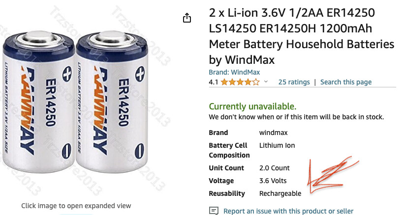

I’m concerned about putting a non-rechargeable battery in a circuit that was designed to recharge. At least iFIXIT specified a rechargeable. The non-rechargeable batteries have dire warnings about trying to recharge them.
Can you share the link mentioned previously on iFixit? I don’t recall any PRAM battery in any of my desktop Mac’s as being rechargeable.
This iFIXIT page iMac G4 17 800 MHz EMC 1936 PRAM Battery Replacement - iFixit Repair Guide linked to this Amazon page https://www.amazon.com/ER14250-LS14250-ER14250H-Household-Batteries/dp/B00XBMEHOO/ref=pd_sim_121_5?_encoding=UTF8&pd_rd_i=B00XBMEHOO&pd_rd_r=NJNZSRVSD3EDXF97P11P&pd_rd_w=RO6k6&pd_rd_wg=FO9d3&psc=1&refRID=NJNZSRVSD3EDXF97P11P&tag=ifixitam-20
That’s one of the ones I found searching but there is no mention of the battery being rechargeable unless I missed it. The battery looks like the same one used in many desktops including the old fruit flavored CRT ones and those are definitely not rechargeable.

The iFixit repair guide you linked was user-contributed, so it’s not necessarily vetted in any real way. iFixit is great, and I’ve used it many times, but there is wide variability in the quality of its user-contributed guides. It’s true that it links to an Amazon page that says it’s for a rechargeable battery, but I wouldn’t necessarily trust its accuracy.

The ER14250 battery type is Lithium Thionyl Chloride NON-rechargeable.
The Amazon ad is incorrect.

I see now but my point is that type of battery has never been rechargeable in my experience and I don’t know of any desktop computer that would have a rechargeable circuit as opposed to a laptop. Any seller can put out information that is not necessarily correct. I gave the link to one that OWC has that should be correct as the models page indicates.
And of countless ER14250 batteries on Amazon some are listed as rechargeable and some as definitely not.

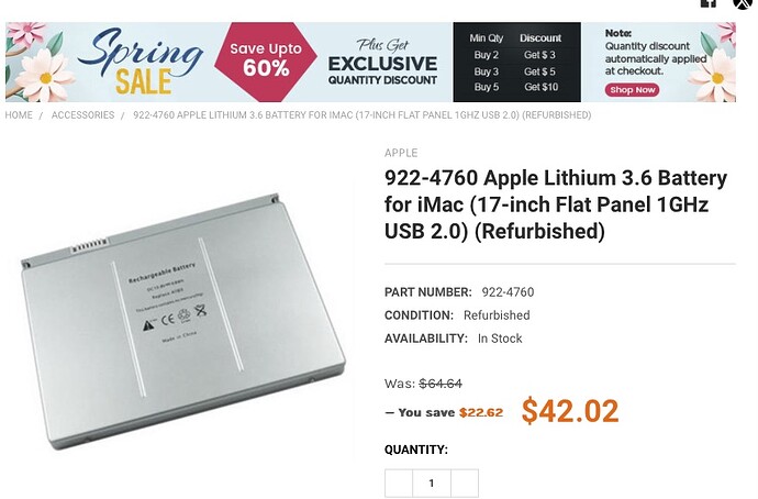

You can search Apple’s site to exhaustion and never find “Apple part # 922-4760”
(or any other part number) but if you Google it, you find this:
No way in hell, is that what goes in my 15" iMac G4.
I had really hoped to be sure that the battery I had in hand when I cracked that case was the right one, because of all times RIGHT NOW is a VERY BAD time for me to have the guts of a computer spread out in a room for a week or two or… :-{
But to me, it looks like a crap shoot. Thanks for all your advice, sincerely. No thanks to Apple.

As stated already, Amazon is not an accurate source of information and you provided further evidence with that post.

Before I cracked my iMac, I did pickup a “non-rechargeable” battery at the local Batteries + so I would be covered either way. And yes, the iMac battery was not rechargeable, but it was replaced with no difficulty.
And to add insult to injury, the batteries whose Amazon page clearly stated were rechargeable…less clearly said in the fine print on the cells that they were not.
