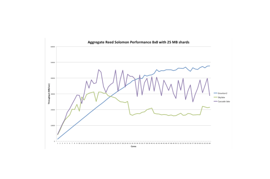

At least by some performance measures, current Graviton2 ARM chips outperform Intel’s Skylake and Cascade Lake processors on a per-core basis:
I take issue with some of the assumptions the authors make, but there’s no doubt that ARM-based chippery is capable of impressive performance.
:slight_smile: Indeed. I should probably have written single-core, which is really what I was talking about. Which is faster in multi-core is going to depend somewhat on the workload, but there’s no doubt the current ARM offerings are very powerful and give extremely good bang per buck.
