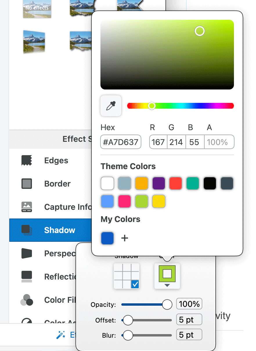

Just another vote for Snagit™. Terminal (semi-permanently) or some complicated key-combo is fine, if you can remember all the keys. Snagit can do drop shadows when/if you want it as well as several added adjustments:
(captured a capture the old fashioned way! :winking_face_with_tongue: )
Of course, you may not feel it is worth the price! ~$31/year.
