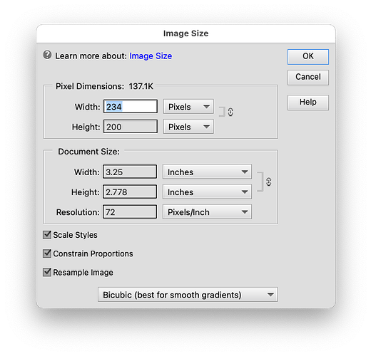

IIRC one of the things I hated about Elements was that it only did measurements in inches. So if II entered pixel dimensions, it converted them to really awkward decimal inches values, Maybe someone who has used it more recently can verify that.

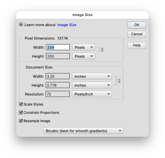

I don’t think that is the case any more. Here are two screen shots from Photoshop Elements 2021’s image-resize dialog:
Screen Shot 2023-09-22 at 00.34.41
Note that you can change either the pixel dimensions (to specific sizes or to a percentage of the current size) with or without preserving the aspect.
Or you can set the document size in real-world units. And as the second image shows, you can choose the units you prefer.
Yes, if you change the document size, it also changes the pixel dimensions. But that’s what I’d expect. If you change the real-world size and/or the resolution, the pixel-size is going to be computed from them. And vice-versa.
I typically set the resolution to what I feel will be appropriate (usually 72 dpi for on-screen images or 300 dpi for printable images) and then enter pixel dimensions, letting it compute the real-world dimensions.
But if you’re trying to make it a specific real-world size (maybe for inclusion in a larger document), then you would want something else. Maybe select the size and resolution and let it compute the pixel dimensions.
