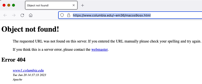

Problem caused by forcing HTTPS for website loads
I got an Error 404 when I tried to follow the link.

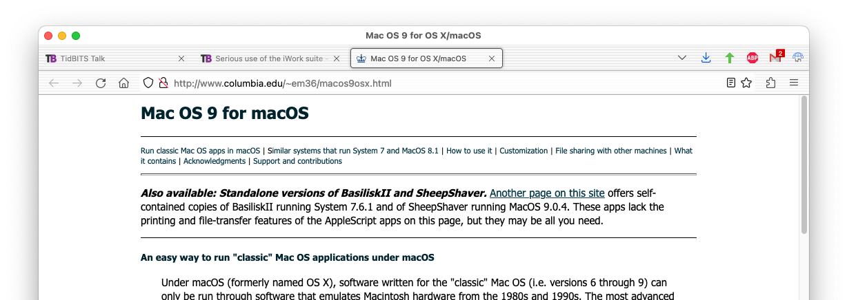

Works okay for me.
Interesting. It’s still broken for me.
Opens fine with Safari 15.6.1 and Firefox 114.0.2.
EDIT: I just noticed that you have https in the address but the site is not secure so just use http.
Strange. It’s working for me (Firefox 114.0.1):

Good catch. An HTTPS URL doesn’t work on that server (didn’t work for me either).
If your browser has some add-on or configuration to automatically replace HTTP links with HTTPS links, you’ll need to disable/override it for this site.
That was the problem. Not only did I have an extension named something like “HTTPS everywhere” enabled, I also had Firefox’s HTTPS-Only Mode set for all windows. Thanks.
