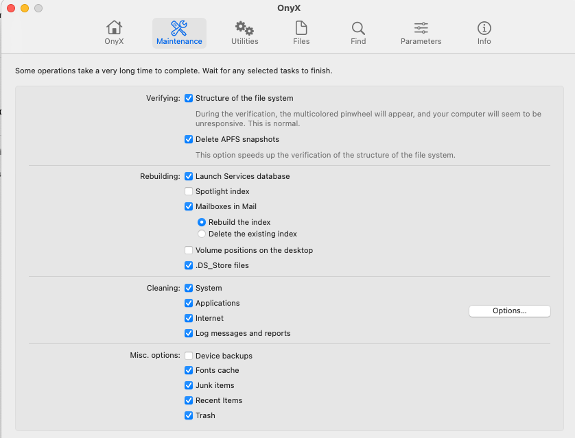

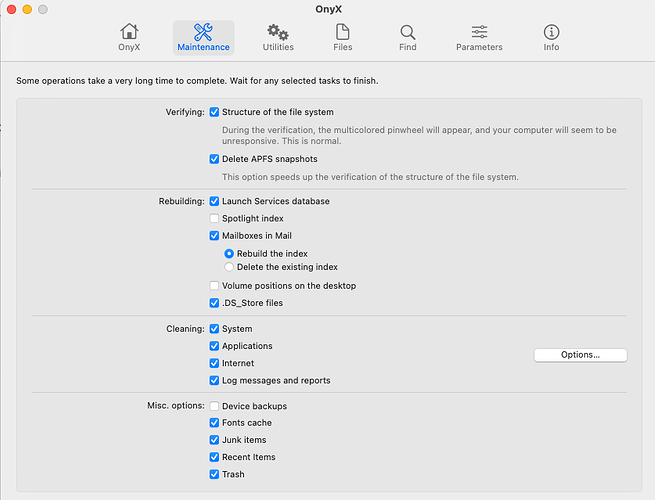

I ran Onyx and that fixed it … for now.
What procedure did you run with Onyx?
