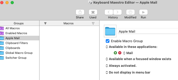

Still confused. I reinstalled it and am trying to follow your example, and got to here:
  • Instead of Available when there is a focused window I chose Available when a focused window exists. Same thing I guess?
  • Where is the Triggered by any of the following setting?
  • Where is the will execute the following setting?
I think I’m getting closer, but it’s incredibly complicated!
