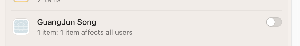

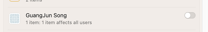

Mysterious login item "GuangJun Song" in macOS 13.6.7
I am trying to identify the software which creates an unidentifiable login item in my macOS installation.
Web search does not reveal any usable clues.
Does anybody know which software this is from?

“GuangJun Song” is the name of the app developer who code-signed the item. macOS Ventura (or maybe Sonoma?) changed its presentation of “login items” to include items which in earlier versions of macOS were not shown, and for an item added by a now-deprecated mechanism, it shows the name of the signer instead of the name of the application that made it a login item or in which the item is contained.
The launchctl list | grep -v apple command may give a clue; it will list all login items that are not from apple, and the third column of the list shows the item’s “label”, which may help identify it.
Note that, because this item says it “affects all users”, it is a “launch daemon”, not a “launch agent”. That means that it probably runs as root rather than as the user, which makes it especially powerful.

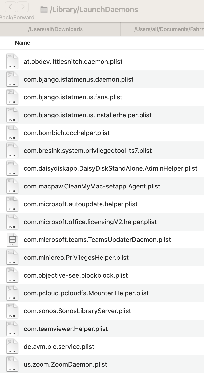

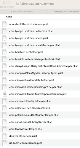

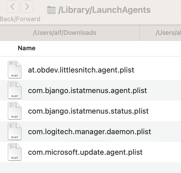

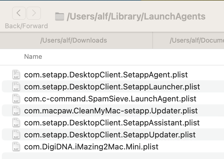

Given that this mysterious start item is noted as impacting all users, the offending plist is likely to be in either /Library/LaunchAgents or /Library/LaunchDaemons.
Could you post a listing of the plist files that are in both those locations. Perhaps it isn’t related to Magnet at all, but some other application that needs a background task.
Here are the results:

Bingo! I think I’ve found the offender. And it isn’t Magnet.
I went down the list of files in the LaunchAgents and LaunchDaemons folder, trying to decipher the developer and possible software that would generate these launch agents.
The hit came on a plist entry for com.minicreo.PrivilegesHelper.plist. From there, I searched for “minicreo” and found the website minicreo.com for MiniCreo - where they have a number of macOS and iOS products. I downloaded the .dmg for their Omni Remover product for the Mac, and ran the codesign utility against the OmniRemover.app file in the mounted .dmg.
