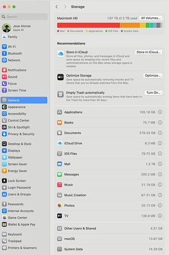

Mail on my iMac Pro (Sonoma) has suddenly ballooned to occupy 1.19 TB of my 2 TB SSD, causing all sorts of headaches with “disk full” messages. (Storage claims I have only 30 GB available). The same mail setup on an Air (M1 2020, also Sonoma) linked to the same server (I believe gmail, our laboratory contracts Google to handle its mail) “only” occupies 70 GB.
I have no idea what happened, or how to recover the obviously wasted space in my desktop machine.

I too am surprised (and quite frankly horrified) by this turn of events. All I know is that the “Storage” thingie in Systems Settings, screen shot attached, indicates the offending data type is Mail.
