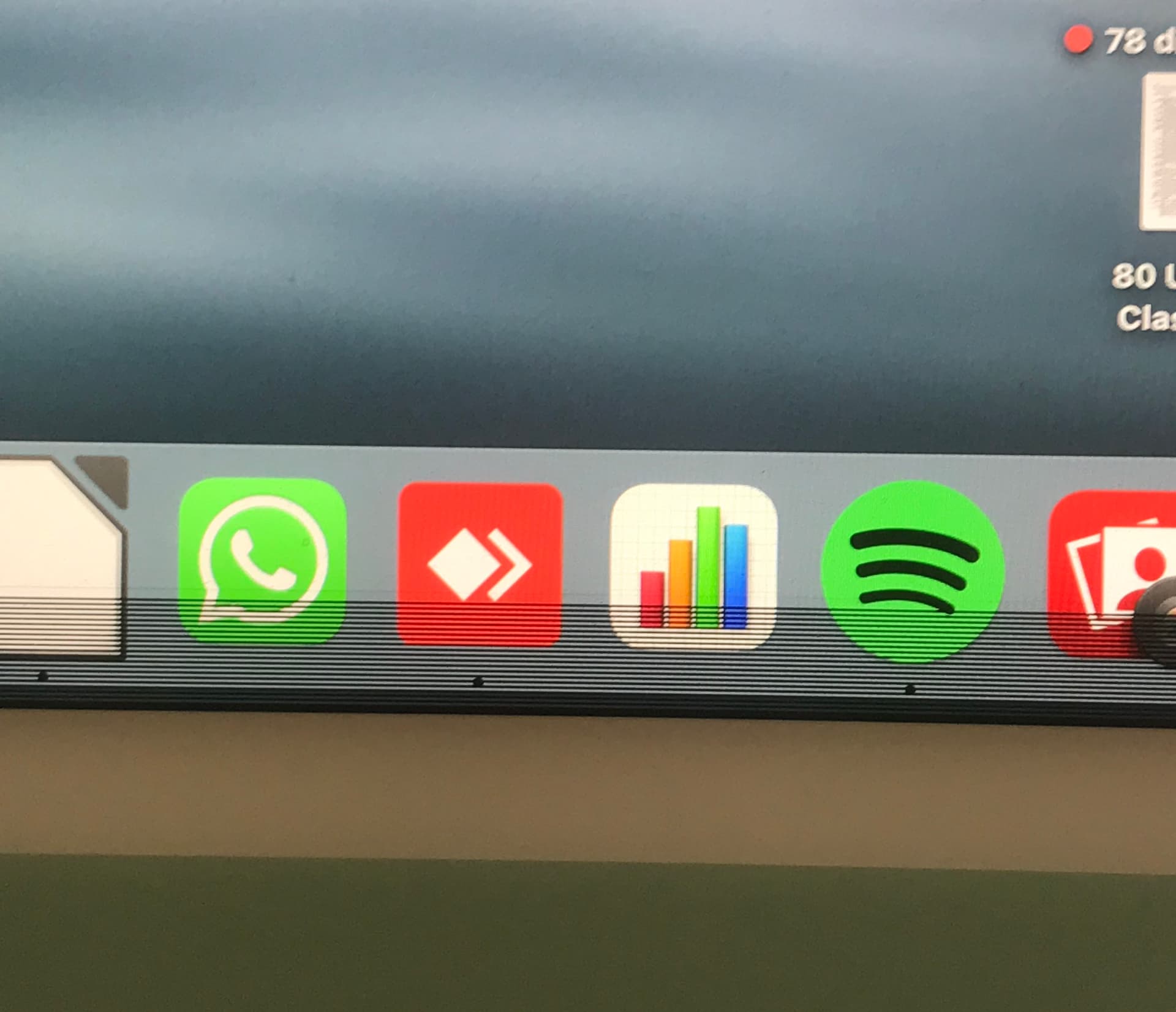

These horizontal lines at the bottom of the screen appear on an iMac M1. Not limited to the dock. They do not show when I access this iMac with a remote tool (Anydesk). Has anybody ever seen these before?
If they don’t show up when screen sharing or when doing a screen capture, then they are almost certainly the result of damage to the LCD panel.
Time for a trip to a repair shop. And a possibly expensive display (or complete top-case) replacement if it’s out of warranty.
An independent repair shop might be able to fix it without a complete top-case replacement, depending on what is actually broken. It might, for example, be a small chip or connector cable. But Apple and authorized repair people don’t do repairs - they only replace large subassemblies, which can cost a lot more than necessary.
