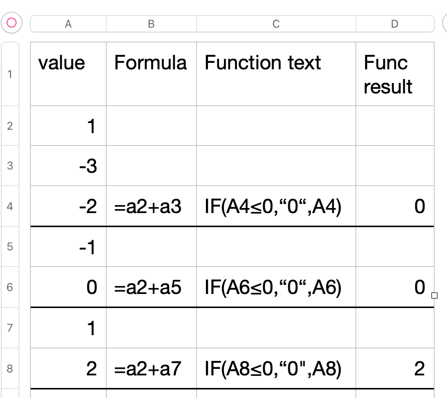

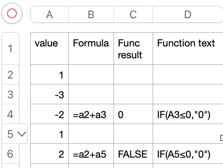

I’ve now re-read the instructions about the sixth time and finally it looks like what I’ve entered is acting correctly:
but is not what I’m seeking. I need, in the example above, C6 to display “2”. I’ve tried adding a comma after the if-true quotes, and a comma and empty quotation marks but those don’t result in displaying the number in a6.
Is IF the wrong function, or should the syntax be different or what?

Try IF(A3<=0, 0, A3) (meaning… if A3 is less than or equal to zero, the formula result is 0; otherwise the formula result takes the value of the cell A3)
Also - I think your formula references are one row out. On row 4, your formula references A3, but I suspect that should be A4…?
Thank you @ashley !!! looks like adding the cell reference did the trick! I had tried that earlier but now I think of it put the cell row and column inside quote marks so of course that was displayed, not the result of the formula! I knew it would be something simple like that!
well observed, I made several tests to screenshot for the Topic and in my haste did not update the text in d4 & d6, sorry. The functions in c4 & c6 correctly evaluated a4 & a6 though.
Just to clarify, the IF function has three parts separated by commas - the test, the result if the test is true, and the result if the test is false. Because your function left off the last part, the result of the function was the binary FALSE when the test was not true.
OK and if it helps anyone, just updated the example, hopefully clearer and more fully and correctly, with full evaluation of positve, 0 and neg values:
The displayed values in column d were the same even without the A4 and A6 references in C4 & C6, which upon 7th (or more) reading of instructions, makes sense, as the if-expression was true and no further evaluation was required.
Phew!
Thanks @ddmiller , more clearly stated than the instructions! Maybe you could offer the Numbers division to rewrite them! For dabblers in Functions like me, the instructions where it says the if-false part is optional, makes it even more confusing!
Yes, as you discovered, it is optional, but sometimes you want that if the result you want is simply the binary FALSE. I usually want a result, but I have wanted a simple FALSE before, but even then I’m usually specific and put that as the “else” final portion of the function.
