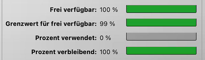

The Terminal is not my comfort zone. I tried Tech Tool Pro 13 and found the info in the attachment. My MBP M1 (16 GB, 11.3 Beta) is 3 month old. (“Prozent verwendet” is “Percentage used”)
