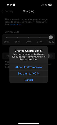

Adding Apple’s take on the subject with this screenshot.
I think it is difficult for anyone except Apple to collect enough data from the field and to contextualize it with how Apple software and hardware interact with each other to optimize charging and battery life. Beyond general battery bahavior, there also is a question of how batteries may behave in different device models and under different use cases. At a minimum, the battery data Apple collects surely dwarfs any data collection by third parties.
Consequently, it is one area of technology that I’ve decided to stop caring about. Sure, if I know I won’t have access to a charger for awhile, I will charge to 100% and enable some settings to lower consumption. Aside from that lone scenario, I now just accept Apple’s recommendations for “optimized charging” for routine use. Apple software clearly is actively managing charging processes, so at least in this area, “fighting the software” is not likely to help.
